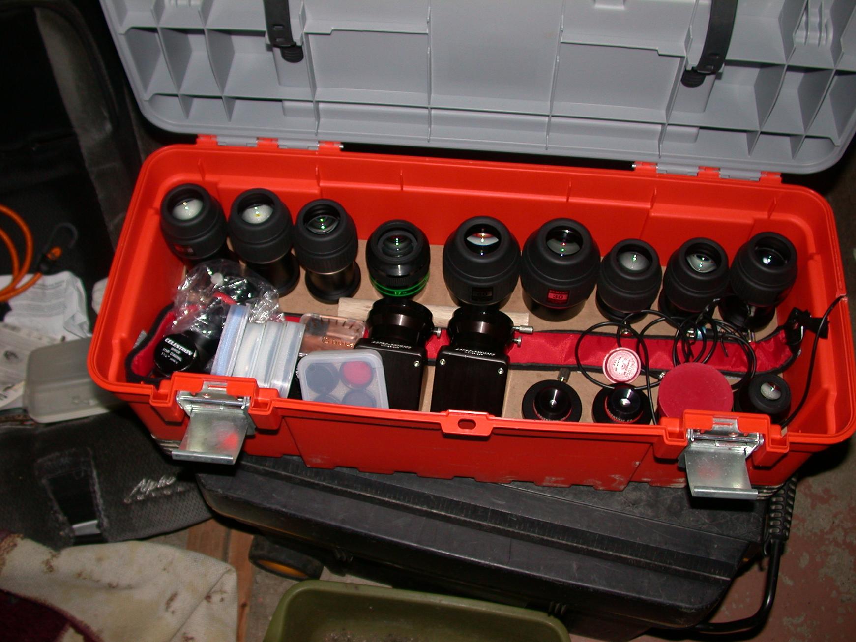

Pentax you say? Why foam? I keep posting this when this subject comes up to remind folks that foam is not necessary. It has certain disadvantages, like getting cruddy. A friend uses an insulated box with plexiglass shelves; to keep the eyepieces warm and dew free he puts a microwaved foot warmer (bean bag) into the bottom.
In the design below the compete Pentax line is housed as well as some other eyepieces and items such as diagonals. No caps, no bolt cases, everything stays clean when the box is closed. The heating strip is there in case I decide I need it for anti-dew purposes.
One item of note: when I was designing the box I was faced with making an "assortment of two inch and 1.25 inch holes" which might not be the right choice as the collection changed, or making everything two inch. I decided to go with all-two inch and to get each eyepiece its own adapter. This has made field use much simpler, and it's practical for the box, any eyepiece goes in any hole, as do the diagonals. Stellarvue makes the best 1.25 to 2" adapters for Pentax especially, with the long barrels.
good luck,
Greg N
good luck,
Greg N
