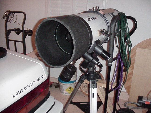

I'm thinking you actually meant to post that you want to make a dew shield ... as the scope already comes with a cap / cover for the corrector.
Here's one I saw on the LXD55Telescopes Yahoo group. It's made from 1/4" toolbox foam from Sears.
tslotwin's attachment for post 72122
Posted 10/13/2003 03:22PM #2
I hate to say these "caps" are a waste of time & material.. but unless your viewing time is brief you are only postponing the inevitable.. to keep moisture off your objective lens the best way is to introduce a slight amount of "heat" with a dew system heater strap. Kendrick makes all different sizes & lenghts.. Good luck, John M
