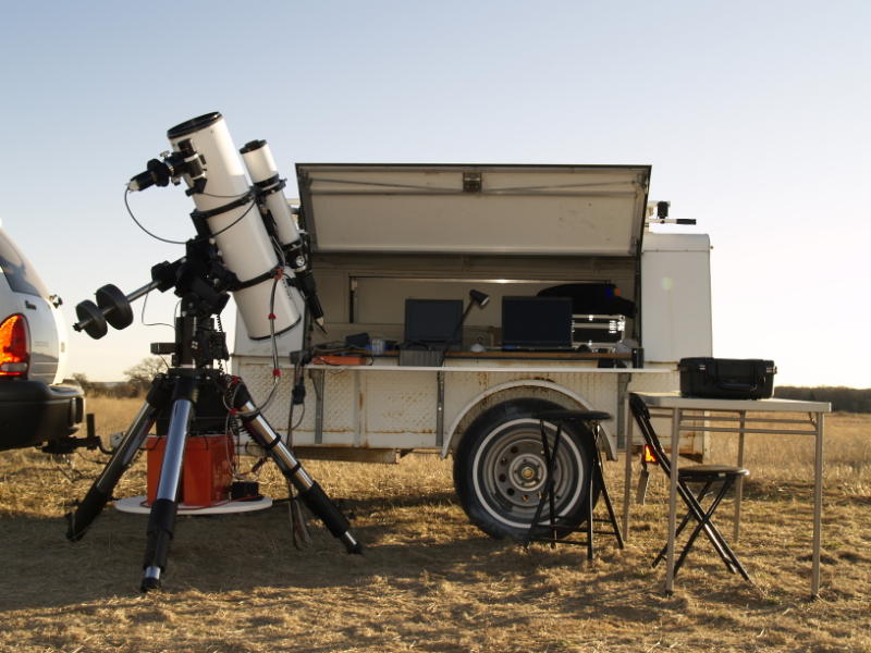

"Never use a car battery if an AGM is within walking distance" ;o)
I use a couple 200 amp AGM batteries to run the scope drive, DSC, 2 cameras, 2 laptops and dew straps when needed. I charge with solar panels during the day and have spent a week out away from power in the DARK of New Mexico. I use "Anderson power pole" connectors on everything so it is simple to set up and multi-port adapters are available. I can even power my Ham radio gear from the batteries. The attached picture shows the batteries on a shelf of the tripod which makes great ballast that improves stability.

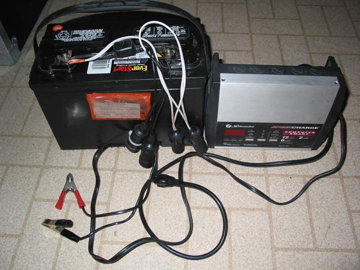

I use a relatively inexpensive Marine Deep Cycle Battery from Walmart, cost $65. If you need more power, then you can just buy two for the $130 and have enough power without spending too much money.
I have not had any issues with out gassing or dry cells, in fact I have never had to add water in two years. It is rated at 115 amp hours and runs a large laptop that uses a bit of current, my ST2k camera and the G-11 mount for two nights. Never tried to run any longer than that though.
A good charger is really important, one that will charge according to battery type and also will shut off when fully charged, so no boiling or over charging occurs.
These batteries are a bit heavy, but they hold a lot of power. They also have wing nut connectors as well as normal terminals making it easy to wire them for use with items.
