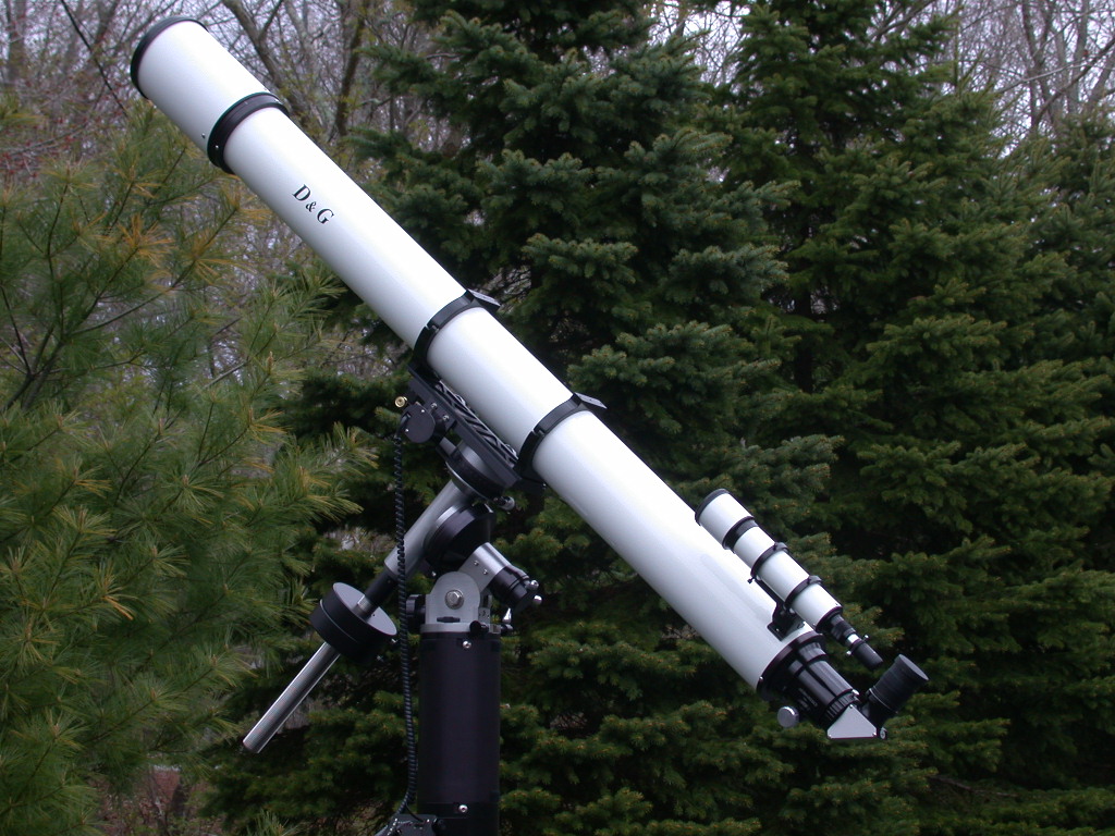

Charlie, I own the last G-100 that was sold. It is anodized black, not blue. Shortly after I purchased it, the G-11 was introduced for almost $500 less. I called Scott and asked if I could return the GM-100 and buy a G-11 instead, since the two mounts looked similar in almost every way.
He said of course, but there are some differences between the two mounts.
He told me that the bearings in the GM-100 are larger, the declination shaft of the Gm-100 is 1.5" threaded stainless, vs. the 1.25" smooth shaft of the G-11, the saddle plate has two securing bolts and is longer. The GM-100 is rated for 75 pounds vs. 60 for the G-11.
However, the GM-100 has a tangent arm declination drive, so it can not be converted to GOTO. I decided to keep the GM-100 and I am very happy with my decision. I found that it easily handled a C-14. It now hosts a D&G 5" f/15 refractor.
No instructions came with the mount.
Dom Q.
daqua's attachment for post 120040
