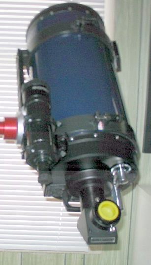

My Meade 7" Mak accepts standard 2" SCT type visual back.
BTW, nice trash find! 8)
Jim7728's attachment for post 131538
