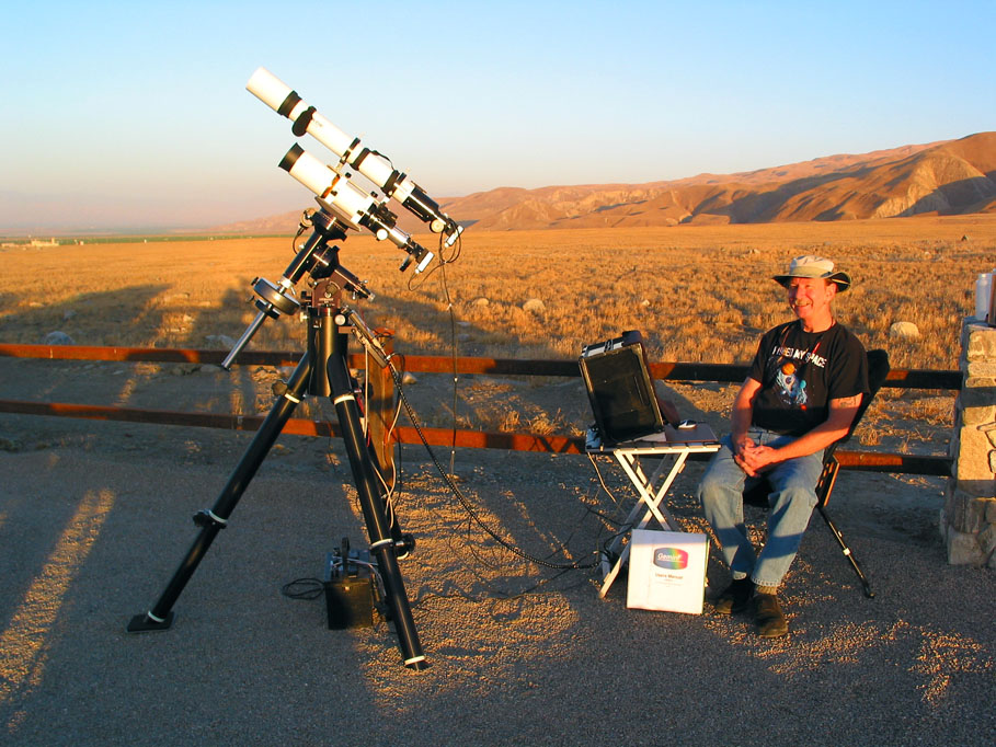

Hi Bill.
My solution is a 115 amp hr Deep Cycle Trolling battery from Wal-Mart for about $70.
I added 4 cigarette lighter plugs to it so that I can power 4 different items. More would be easily added.
These batteries have a 1/4" stud with wing nut as well as the regular battery posts. These make it easy to attach cords or what ever.
I set it under the tripod and attach the wires and run all night long without power concerns. You can see it in this picture.
The total cost was under $100 including the plugs. All that you need is a charger for the battery. It even has a nice carry handle to make it easy to transport.
fblue's attachment for post 119443

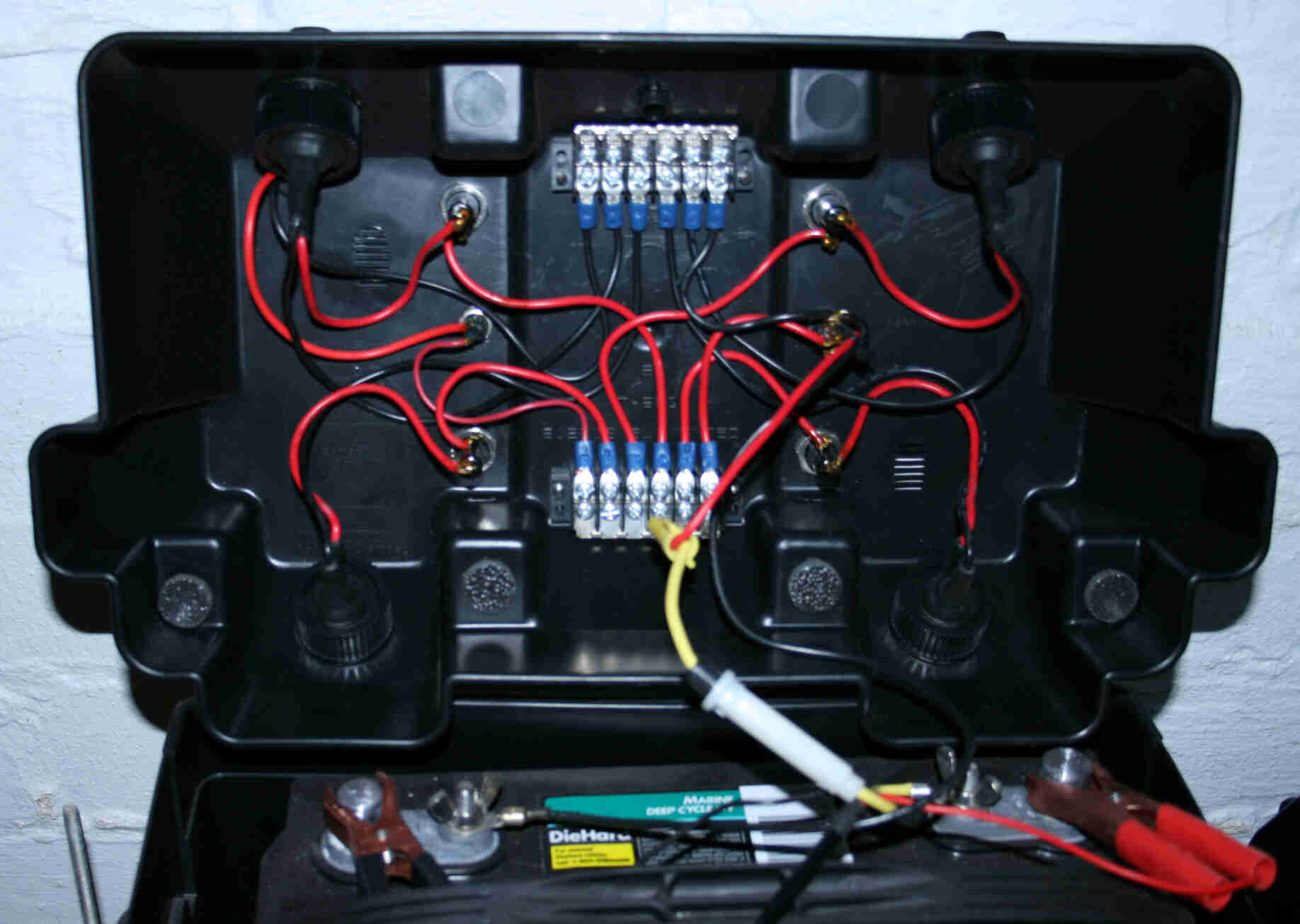

Here is what I came up with after being too cheap to buck up $500 for a Kendrick outfit. I used a marine battery box and a deep cycle marine battery. Each outlet is fused, as well as the main positive feed. I keep a trickle charger (i.e. battery maintainer) on it at all times when it is not in use. So far 3 years and counting. I built another with a little different layout, but the principle is the same.
swsands's attachment for post 119475
