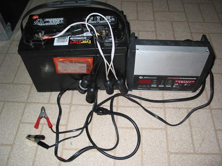

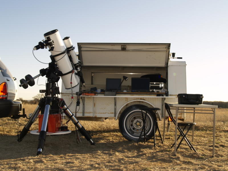

Do a Google search for "12v Travel adapters" I found really nice 12v travel power supplies for my Toshiba and Dell laptops. As I remember I only paid about $40 for one and $20 for the other. I power everything from 2 100A AGM batteries and charge with 45w solar panels during the day. The batteries make great ballast for the tripod. I spent a week out in the dark skies near Datil, NM and the system worked great.

Large Deep Cycle battery, with adapters for your laptop. The scope and camera and laptop can be run from a large battery for quite a while. I use a 115 amp hour Trolling Motor battery that I bought at Wal-Mart for about $65 and it has a carry handle and 1/4" wing nut connectors which makes it easy to wire for your connections required.
I rarely use mine for more than one night of imaging before recharging it, but 6-8 hours of continuous running is typical for me. Never get below 12v on the battery, even though I run a large 17" laptop, G-11 mount and ST2000 camera.
