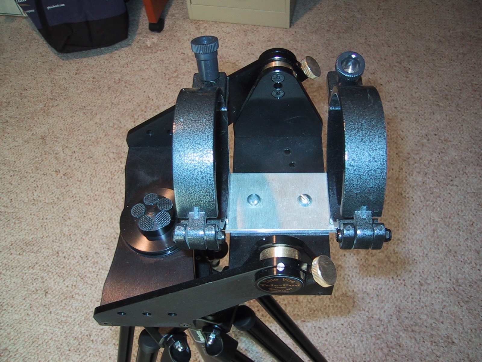

Posted 01/21/2003 03:23PM #2
Hi Clyde,
Owen has given good advice on how to overcome the balance issue. Even if you decide to go with rings to mount the OTA, you'll need some sort of adaptor plate for mounting the rings since most 80mm rings other than the TV clamshells will not fit within the yokes of the Upswing mount. Some sort of pan head is therefore required on the tripod. The photo shows a simple home made adaptor plate with a pair of rings for a Stellarvue 80mm refractor. The mount in the picture is a Telepod, which other than having an integral azimuth bearing, is the same as the Upswing.
Jim
jmcarp's attachment for post 64429
