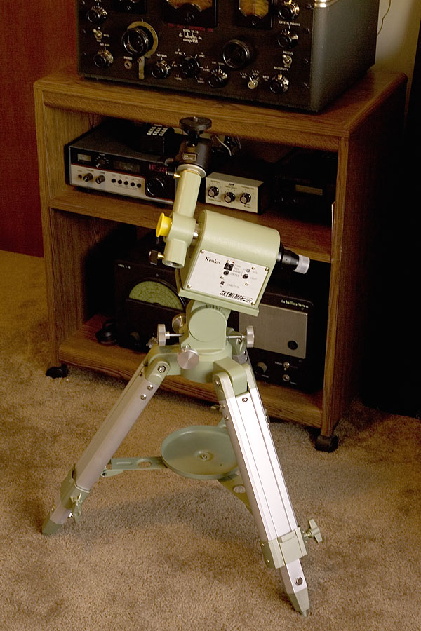

I am by no means one of the decent images here but I just snagged one of these on the used market. All you need is a camera. Should be great for the wide field stuff. Compact and very portable, no scope either. Some links that you may find interesting, maybe not either.
http://www.mindex.be/astronomy/displayimage.php?album=lastup&cat=4&pos=1
http://www.cloudynights.com/item.php?item_id=1591
http://www.pbase.com/lumodomo/lens_telescope&page=all
-JW:
SmokeDaddy's attachment for post 125946
