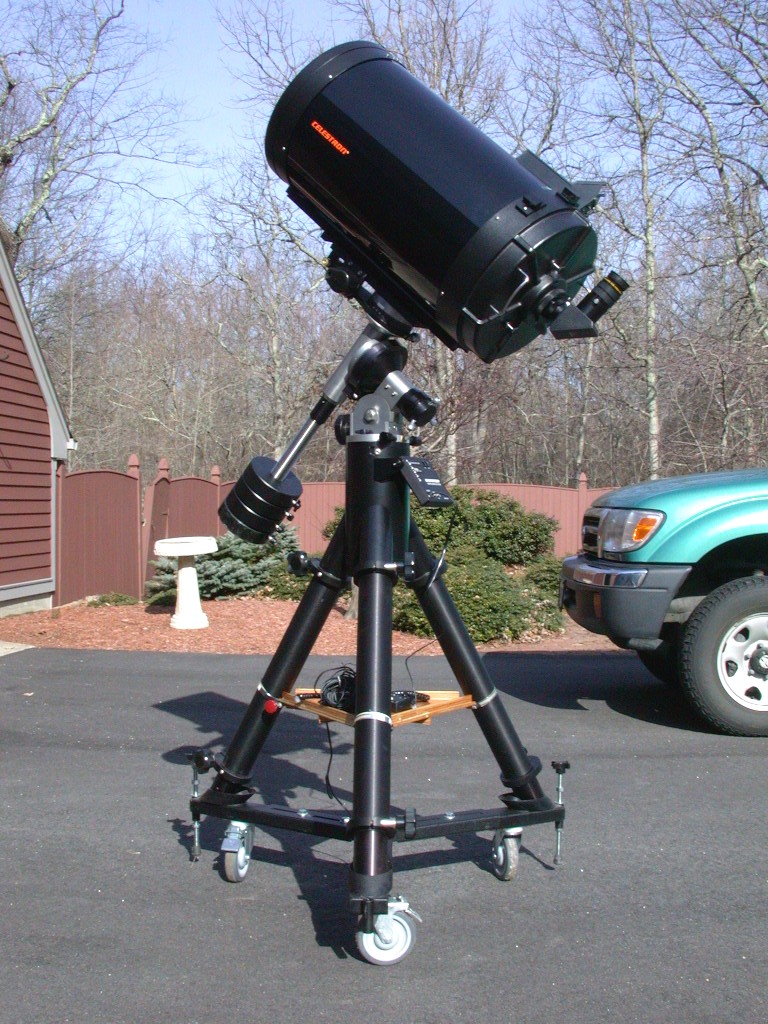

Posted 09/25/2004 09:58AM #4
Dick, I assume your setup will look something like this. (C-14 on a Losmandy GM-100) When deployed, the leveling bolts rest on blocks of wood and the nuts both on top and at the bottom of the bar are tightened to prevent wobble. I don't think I would chance rolling the rig over grass, though.
Dom Q.
