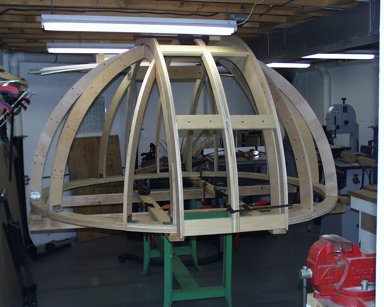

I week to mock it up. I have to get the shutters working and then I"ll disassemble and begin building the walls. I have to wait for Spring before I can cover and final assemble it.

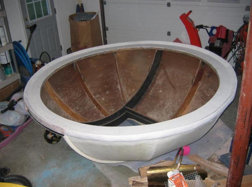

Bob, your dome frame looks professional, you must have a ton of hours in this so far. When trying to exactly matchup the wall "top ring" with the under side of the dome, I had good luck flipping the dome upside down. Also consider a good overlap to keep the rain out - I only went 1 1/2" using bondo and some rain still gets in. Good luck and keep posting your progress.
