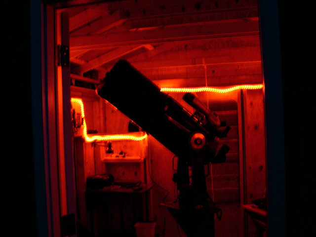

Posted 11/24/2003 05:22PM #1
I took someone's suggestion on this forum and installed rope lighting on a dimmer switch and it works great. I am thinking about installing a small space heater on a timer to deal with condensation during periods of rapid temp changes during the winter months...when a warm front comes through after cold weather, condensation forms on the cold metal surfaces...a little heat now and then might help. I found that short pile carpeting around the pier area has been a life saver when I've dropped something in the dark...my floor is masonary, but your wooden floor might be more forgiving...I used a ridge vent with soffet venting for air circulation...I'm also going to install a small oscillating fan for the summer months to keep the mosquitos at bay....good luck with your observatory...you'll probably wonder how you ever did without it.
John
