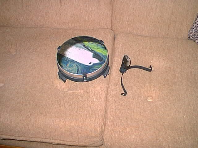

Posted 02/17/2006 01:47PM #2
Hi
I have had all my mirrors coated with it and cleans great. I keep my mirrors inside in the house so I don't know about storage in a garage. My first mirror is 3 yrs old as good as the day I had it coated. Well and the price umm the other mirror makers are lets say much higher. Also if you want to come back later and refigure as your mirror making skills get even better you don't have a ton of money in the coating. That is the great thing about making your own . Don't take my word look at the picture.
kb4mxo's attachment for post 100973
