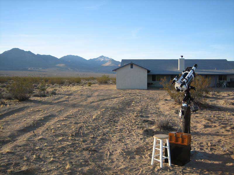

Tonight is first light for my new permanent pier setup at my new home. I use a Vixen VC200L on a Losmandy G-11. The pier is a 7" diameter thick-walled steel pipe backfilled with sand for vibration dampening. You only see about half of the pipe. The other half is underground and is held in place by a 2'x2'x2' concrete base. I also ran electrical out to the pier, running the line 18" underground in conduit. I plug into an outlet on the back porch.
Next year I will start working on the observatory proper, but for now I think this will suit my needs.
The attached photo shows the setup and the view to the northwest. Those are the Eastern Sierra Nevadas in the background.

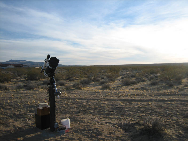

This shot is the view to the south.
Cheers,
Jason
