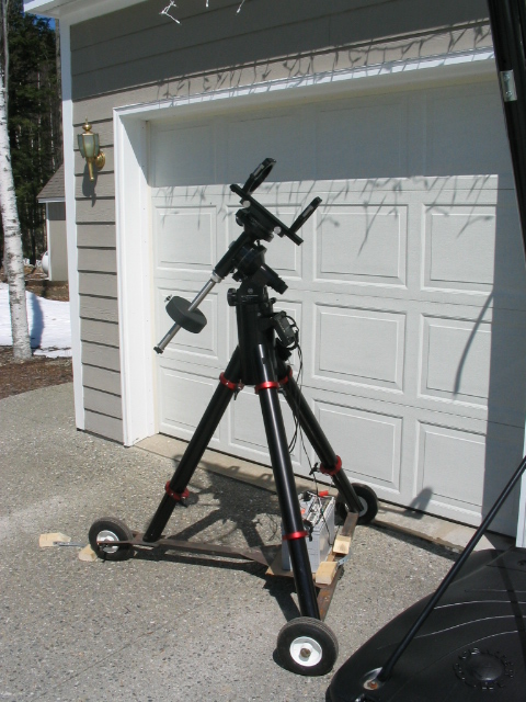

Attached is a picture of a G-11 on my home-made wheeley bars with pneumatic tires that rolls very easily anywhere. It is always set-up. The driveway has index marks so that it is 95% aligned when parked. The tires are from Grainger's catalog, and the frame is channel iron. Less than $100 in it, and far superior to "wheeley bars" which I had previously owned.
