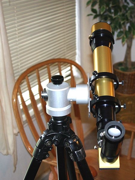

Posted 04/25/2004 02:21PM #5
There is nothing smoother than a Giro mount. Once you have the scope balanced, you push it like a dob and it stays put. That is what I use for my Maxscope 40 solar scope, and I just started using it for birding with my Televue 85. I have the Mini Giro, you will probably have to get the regular size Giro.
Ralph
Panotaker's attachment for post 78974
