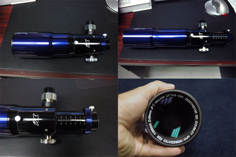

Posted 09/28/2007 06:06PM | Edited 09/28/2007 06:07PM #3
Chris, as many suggested, maybe the 66mm WO SD might be the one for you... (I forgot to take into consideration "the size" of the scopes I mentioned, and they might be a bit too much on top of your 8" SCT)
I personally own the WO 66SD and love it! 8)
IGastaldo's attachment for post 117204
