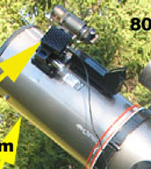

Posted 02/22/2007 02:21AM #3
Hi Paul, here's where I put it on my 10 orion.
Bob
RUSTY845's attachment for post 111815

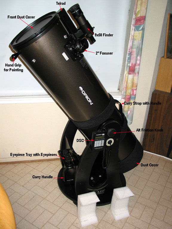

Posted 02/23/2007 01:10AM #7
Here is where I mounted mine on the 10" XTI.
fblue's attachment for post 111839
