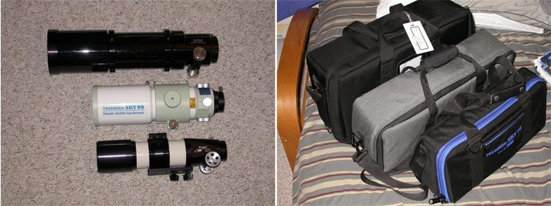

Hi Joe,
I have used these three scopes in the picture, and enjoyed them all. The Pronto can be had for a reasonable price used, and the case holds a number of eyepieces which is very convenient. The Traveller weighs a lot, and although goes onto an airplane easily, is just plain heavy to lug around. My current favorite is the Sky90. Lightweight, and does a good job of pretending to be a 4" refractor. It handles wide fields and high power with ease.
I also have the Telepod and really like it. It turns an ordinary photo tripod into a balanced alt-az mount. But high power planetary views will drive you crazy trying to track anything over about 80X on these : )
Can't comment on the SV or TV76,85scopes, but have heard many good things, and they also come up very reasonably on the used market.
